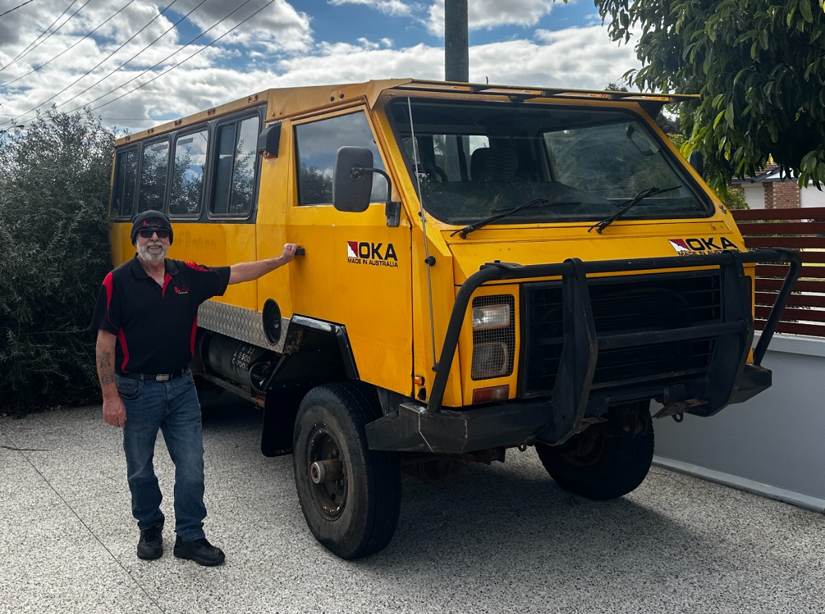

Having recently purchased OKA LT #251, I am now in the stage of determining which way to go with a rebuild.
She certainly needs some love and attention, so I am intending to remove the bus body and cab over the next couple of weekends, to give me much better access to the chassis etc.
My primary concern at the moment is to get it up to an A1 mechanical condition, the cosmetics can come later.
I am thinking a Cummins 6BT and Allison mated to an NP205 Transfer Case is the direction I'll head in. I've had a brief chat with Kelvin from Marquand engineering regarding supplying the 6BT and Allison, not a cheap exercise, but I want this thing to be ultra reliable. I'll also probably upgrade the Dana 60 and 70 axles to 35 spline and HD knuckle as Dana 80's will be out of the budget for now.
For those that have fitted the 6BT and Allison to an LT and a married NP205, how difficult a project is this to undertake myself? I'm not a mechanic but can usually cover the basics no problem. Any advice regarding cross members or mounts that would have to be fabricated and any other gotcha's I should be aware of?

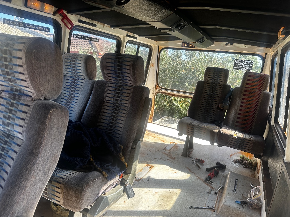

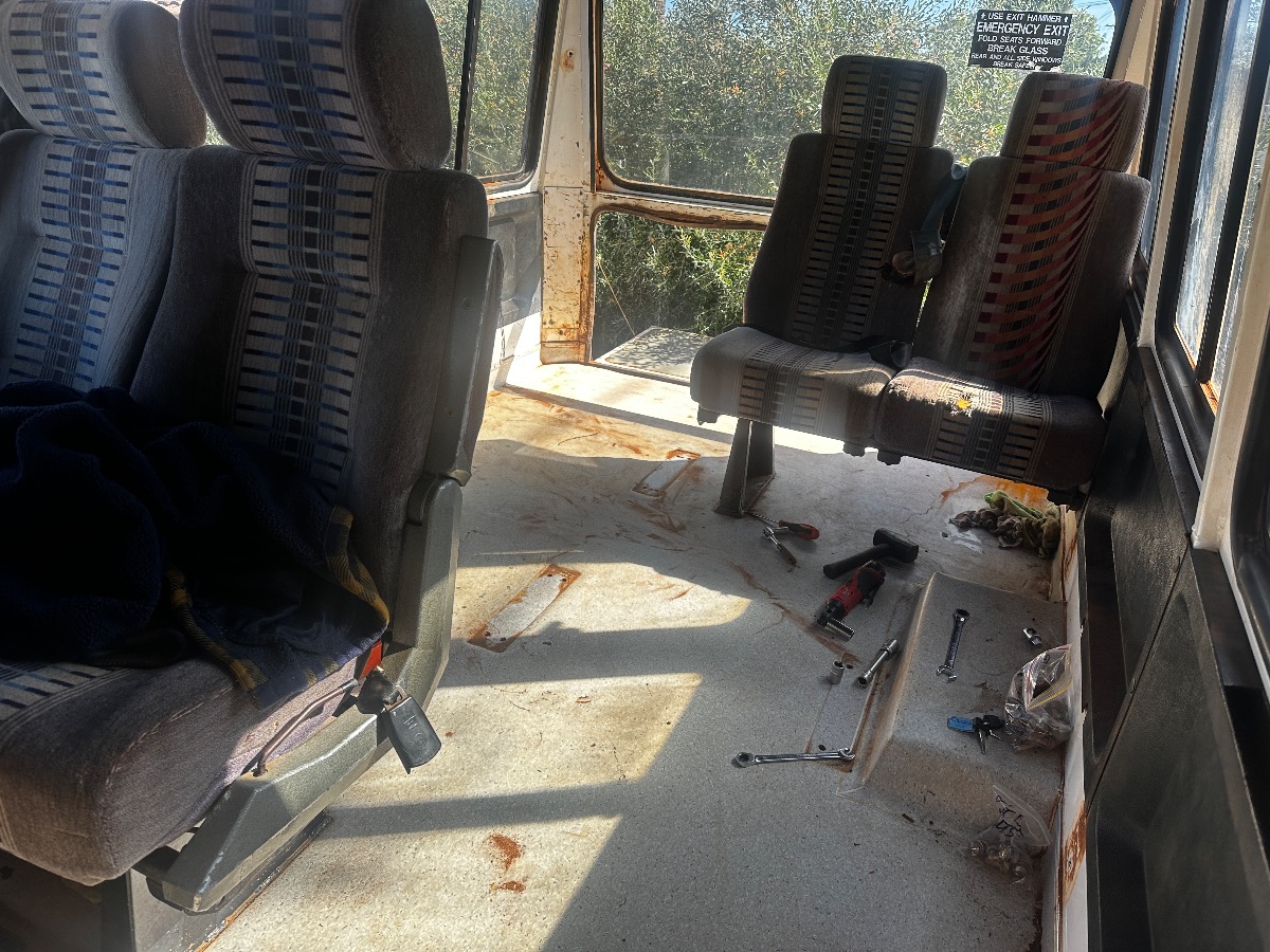

Finally began to remove the bus seats today, and wondering who came up with the idea to bolt them down using nutserts! Every 2nd one spun the nutsert while trying to undo the bolt. Prick of a job when doing it by yourself and trying to use vice grips from the bottom to hold the nutsert.
Anyway got there in the end.
Will begin undoing the bus body bolts tomorrow.
