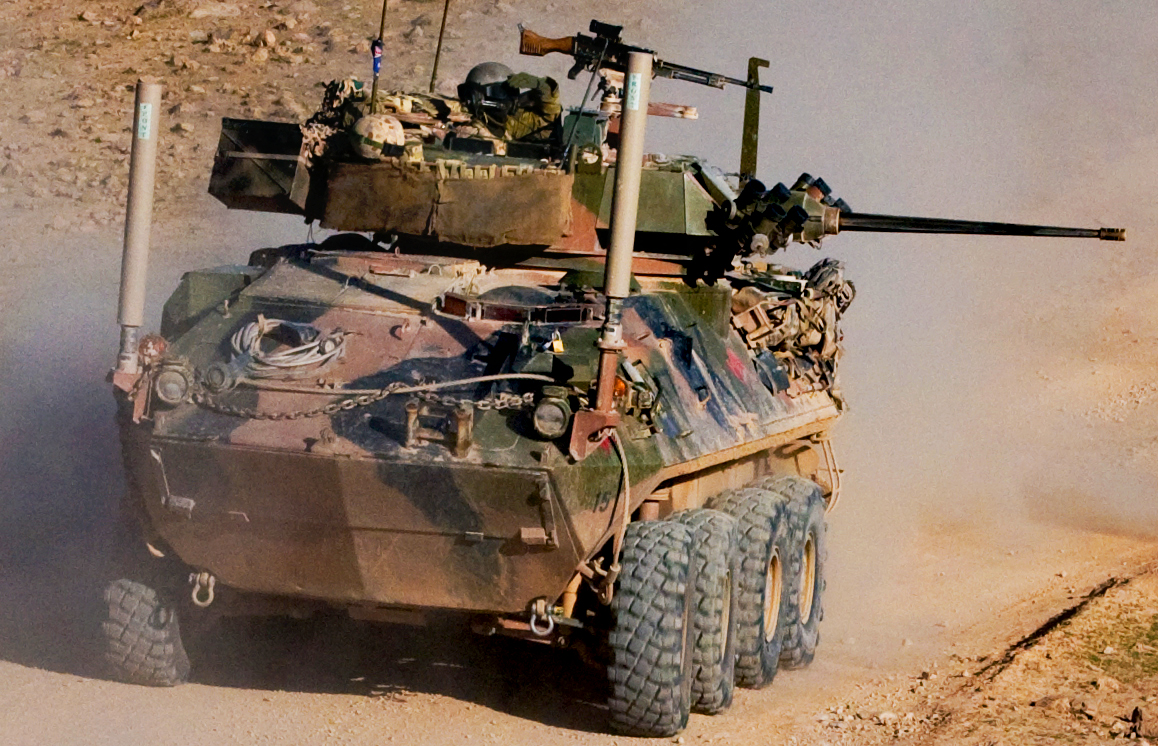

The tyres I was running were 325/85 R16 Michelin XML's. probably the best off road tyre available in the country at 39" but bloody heavy. Ian Jones here in Melb has them and also rated steel rims to suit which is where I got mine. They're available from Michelin at vast expense ie. $1500 or so but a lot cheaper from Ian.
You may have seen them before on one of these vehicles
They look very good on the Oka, aggressive as hell they really look the part but not the best choice for highway work.
