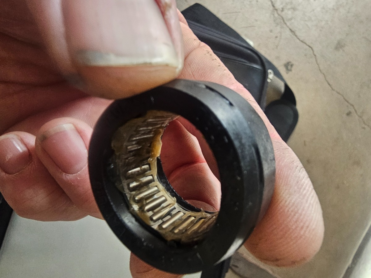

Getting odd knocking noises from the upper sc on certain bumps...since all the lower parts are recently refurbished they get a clean pass...so out she comes and the bearings are horribly grindy sounding...but alas no supplier has any source of the lower roller bearing, a type DG20...see pic...any leads here appreciated (Paul and Ian don't have)....

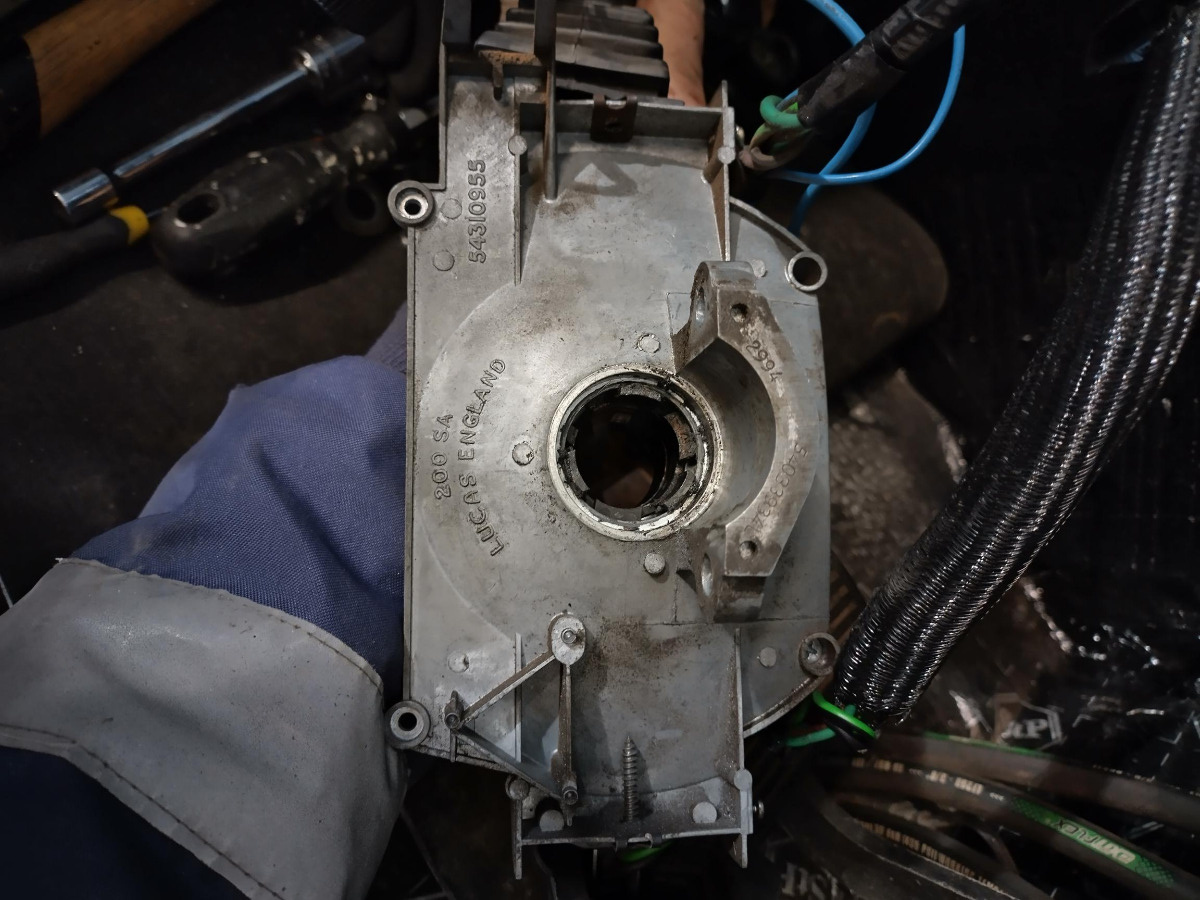

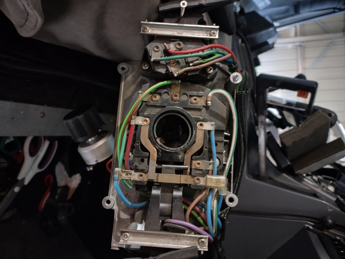

And while we're at it....the Lucas switch and key housing that bolts to the column has a plastic sleeve in the centre...it is loose and rattles...does it perform any function other than a liner coz I intend to slap some sika on it to stop is rattling....

Can't help with the bearings but the plastic sleeves are what cause the rattling on rough roads I've been told, never had mine apart to have a bo peep.

The top bearing is a commonly available "6805" - sorted. The lower one is unobtanium DG20, so I am forced to clean and regrease it then refit it. The rattling plastic sleeve in the Locas upper switch housing is now secured with silicone goop. On driving the whole effect is markedly improved. However if that lower bearing should let go there must be some machining to accomodate something more readily available...or else a complete steering column and switchgear transplant...

The Lucas switch 'base' that the wiper and indicator switches attach to is Lucas 54310955....so I punched it into a search and just one hit came back...strangely it's in a UK town where my Sister lives! So She's picking it up for me...12 UK quid....I've no immediate need for it but, hey, got one spare now....

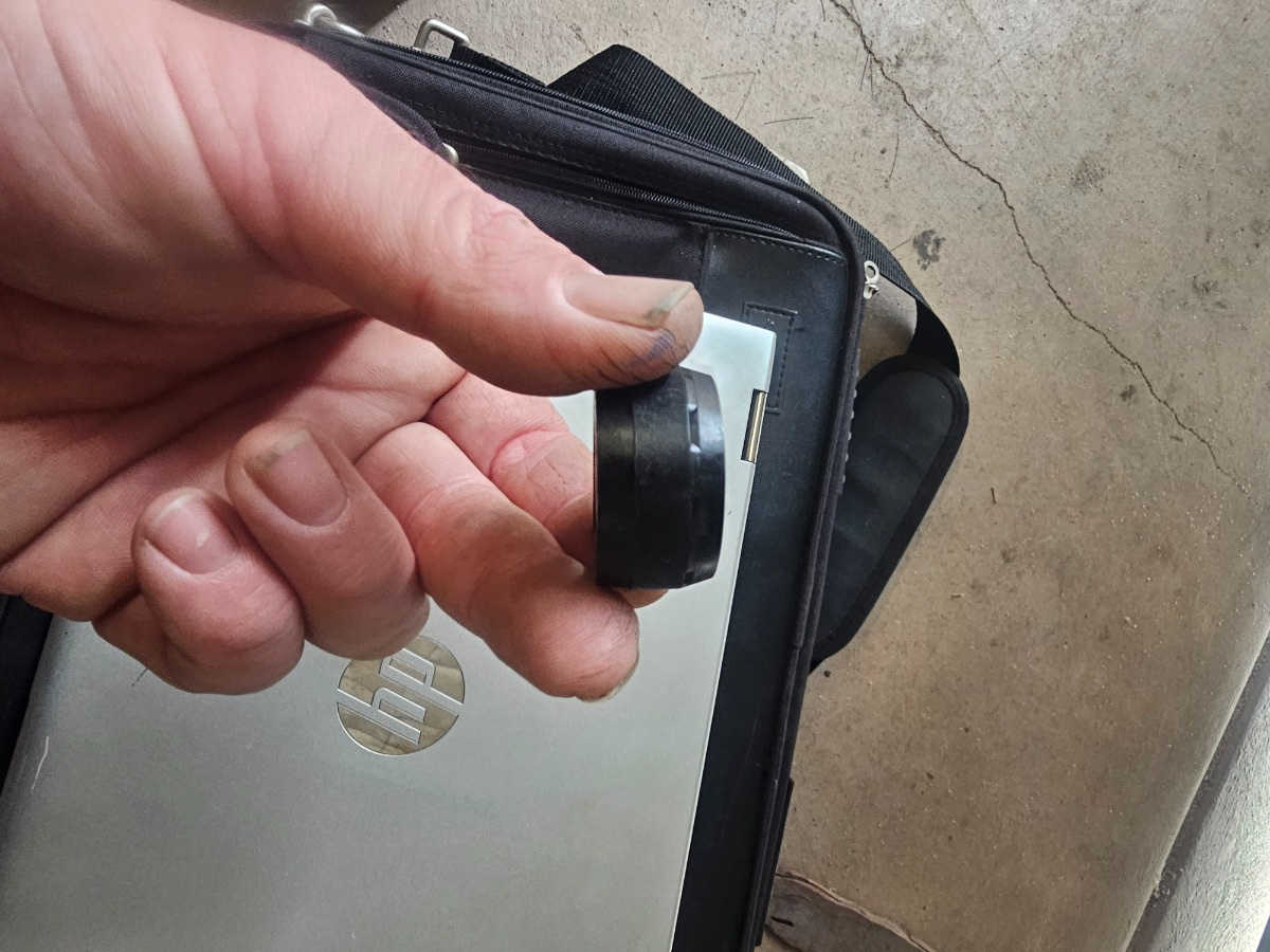

08 Oct 2025 19:16 #10 by Dave Blythe
Dave Blythe replied the topic: Upper steering column
Hi Dane - the bearing (see pic) is back in until it isn't. In the parts manual it has a number but the bearing isn't shown exploded out of the upper steering assembly. Mudgee bearings have no idea what it is when I took it in to show them. Does the ones you're referring to look like this? Plastic thing with splines on the outer and rollers inside?
I'm overseas until May so it's not a major hurry and the old one, once washed out and re-greased is doing OK but will be nice to have one ready to go in.

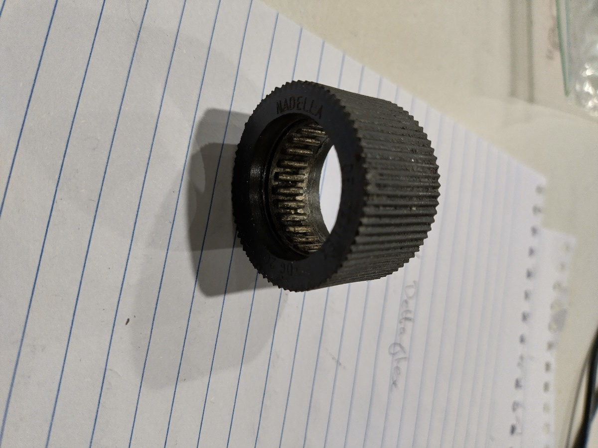

09 Oct 2025 08:28 #12 by Dane
Dane replied the topic: Upper steering column
Hi Dave,
This is what it looks like when new.
10 Oct 2025 11:50 #13 by Dave Blythe
Hey Dane, well wow! That looks like it.
