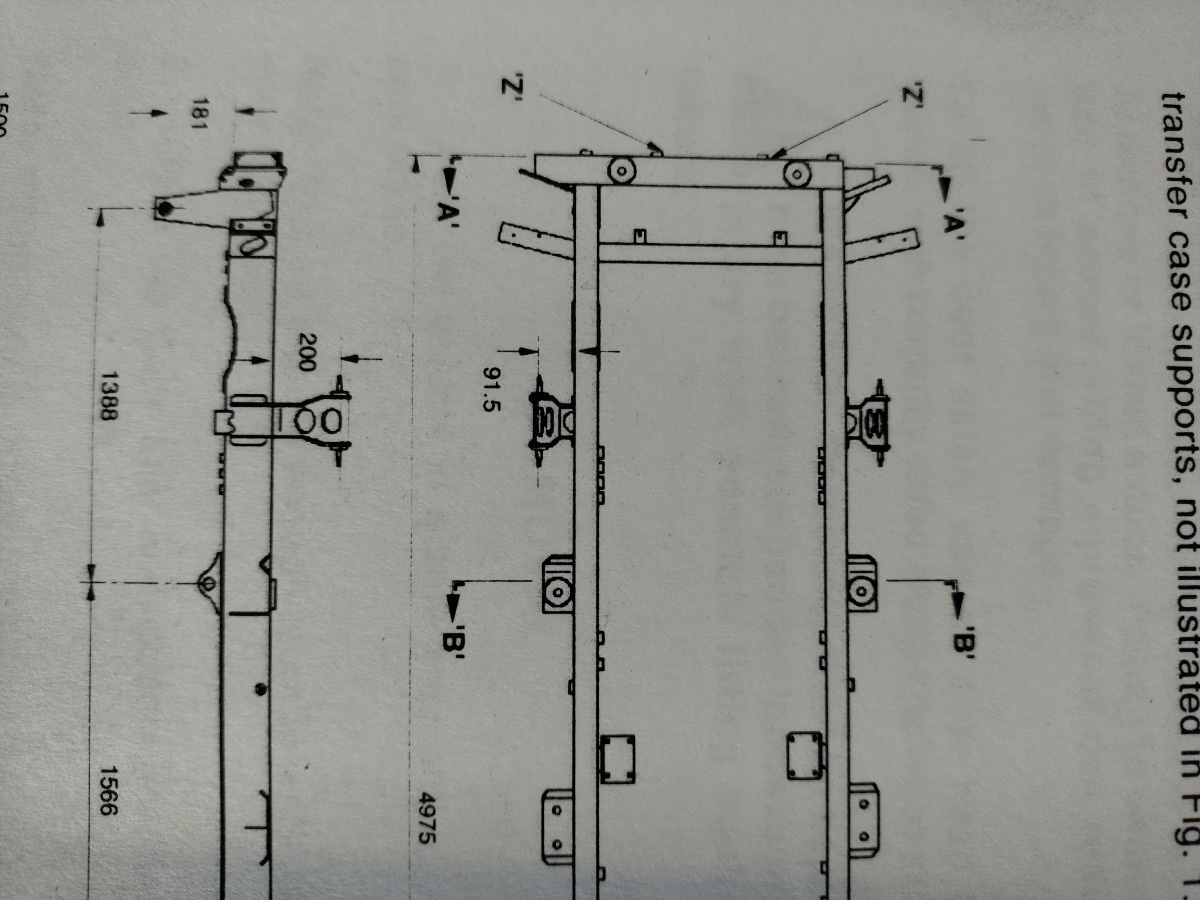

Looking at the drawing it appears there are only mounts at the SC cab rear....can this be true....can't see any forward cab mounts underneath or on drawing....can someone here help this dullard understand if and how this can be?

The mounts are the drawing They are the 2 circles on the frount cross member.

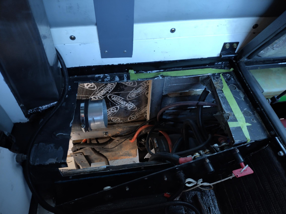

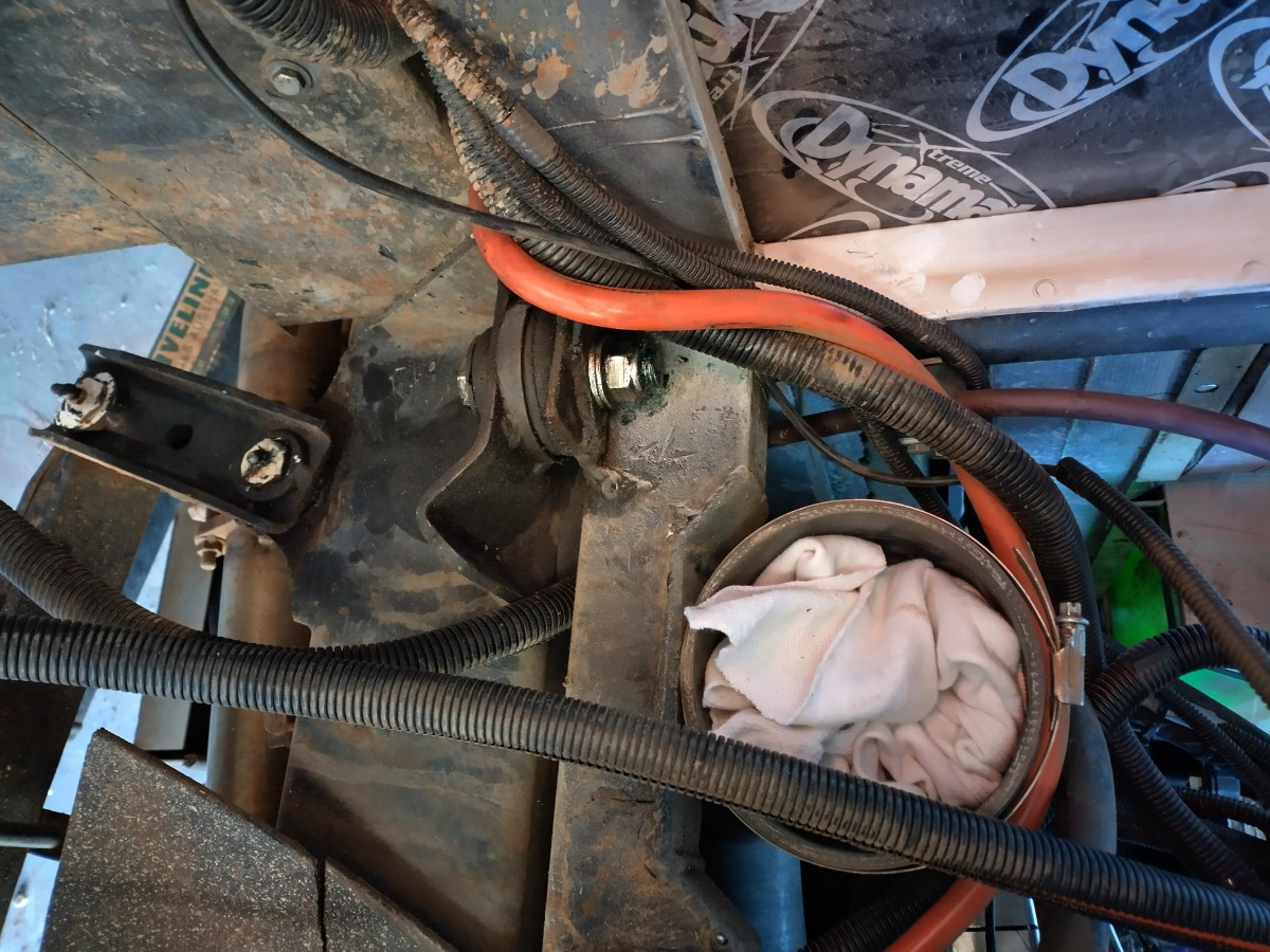

Today's comedy begain quite lowkey having easily cut the seized cab mount bolt on the Pax side and replaced it. But then I moved to repeat the feat on the driver side...pah! The Cummins air filter and a bunch of cables I'd run in the compartment completely obscurred access to the cab mount....so, out with the air filter...but could I reach the hose clamp fixings? Nope!
Easy answer was to cut an access hole into the compartment from behind the driver seat...now I can remove the clamps and hoses attaching to the filter...side benefit it allows very open access to the various air hoses and cables etc...so will place a hatch behind the seat with rivnuts all around so it won't be a pain to service the cab mounts...

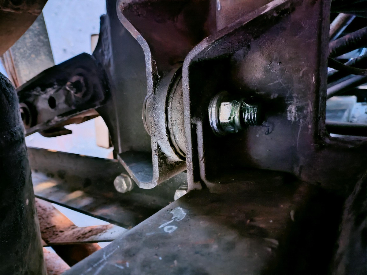

I cranked up the rear cab mount bolts 2 days ago and went to inspect today....they're failing as they;ve developed cracks in the sides and the pre-load has come off the nuts by quite a bit. I wonder if the cab mounts can be replaced without actually lifting the cab off....perhaps I can jack it up a few mm and slide out the old ones?
