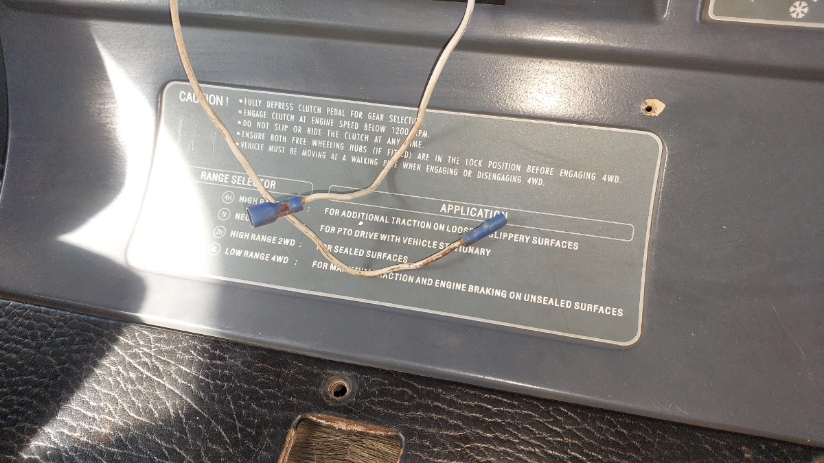

27 Apr 2025 15:03 #4
by peewee65
peewee65 replied the topic: Reverse Light Switch
No switch on the gearbox but a switch on the dash which also turned on the external flood lights

28 Apr 2025 17:50 #6
by peewee65
Usually a reversing switch is obvious but after spending time looking for anything with a wire attached dug into the wiring loom. This was fitted with a switch on the dash that wasn't connected to the gearshift in anyway.
I'm going to fit a reverse switch to the gearbox instead of the current blanking bolt.
If that doesn't work I will fit a microswitch
