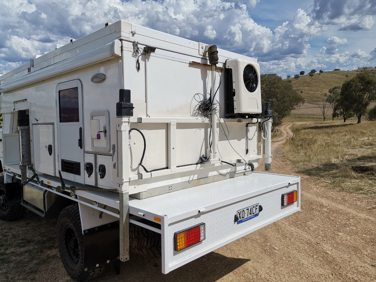

....re AirCon.....I fitted a 12 volt "truck cab sleeper" chinese AC to 297 slide on camper rear. Bloody great for about $1000. Having said that it hardly ever gets used since (a) the camper seems not to get too hot and (b) we tour in the cooler months anyways. Just FYI these units (inside) are really well built with very minimal but strong parts such as the copper tube is way way thicker than the crappy Dometic unit that the PO had on the roof and let go after a few corrugations...this unit crossed the Canning Stock route and didn't flinch...good units.
The following user(s) said Thank You: mat-with-one-t

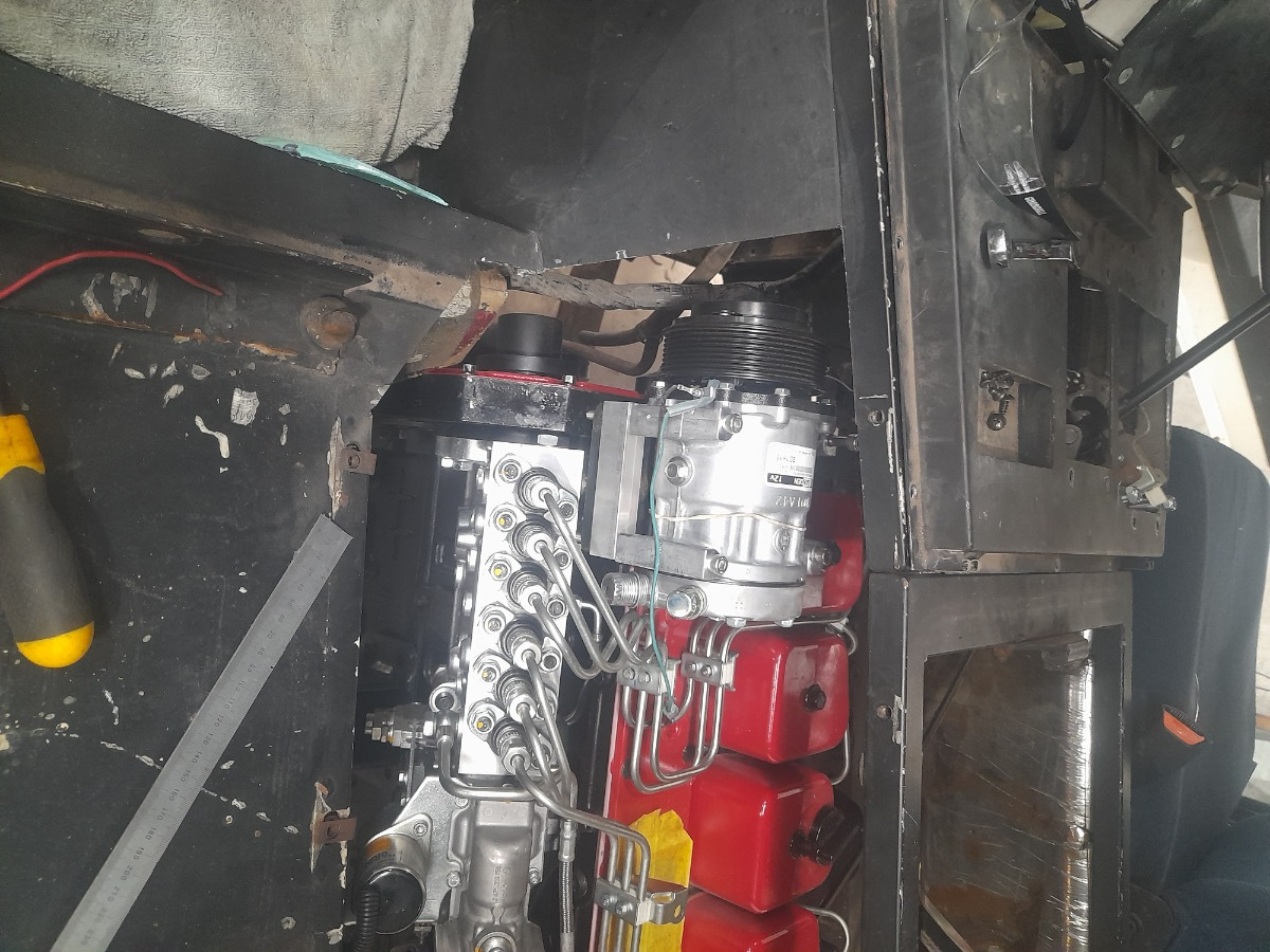

Hi Mat...."- XT has a wider engine bay making Cummins conversions easier".....some take the cab off completely to do this...the guy that did mine (LT) didn't however and he said it wasn't a biggie. For maintenance and better access he/I cut the existing access panels bigger and likewise fettled the cover to fit the larger holes. Rivuts are a godsend. Seen here is the engine being installed and showing the enlarged access arrangement.
Last Edit: 03 Oct 2025 19:56 by Dave Blythe.

Dave Blythe wrote: ....re AirCon.....I fitted a 12 volt "truck cab sleeper" chinese AC to 297 slide on camper rear. Bloody great for about $1000. Having said that it hardly ever gets used since (a) the camper seems not to get too hot and (b) we tour in the cooler months anyways. Just FYI these units (inside) are really well built with very minimal but strong parts such as the copper tube is way way thicker than the crappy Dometic unit that the PO had on the roof and let go after a few corrugations...this unit crossed the Canning Stock route and didn't flinch...good units.
Yeah that's the sort of thing I was thinking Dave. Many thanks. It seems like a good idea to keep it out of the way and protected from low branches. Also keeps the pop-top lighter (with only solar panels on top, may not need actuators - just manual? Not sure). I note that Earthcruiser use this approach with the AC centre mouted, soi can still get 2 spares on the back......
