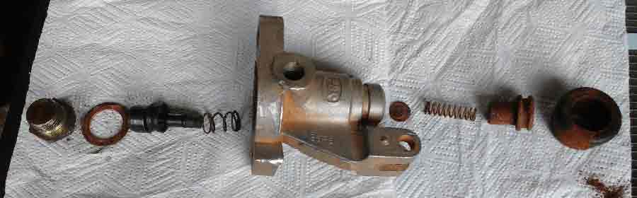

I pulled the load sense valve off 135 as it was seized solid. Pulled it apart and then tried to get a rubber kit for it. Doesn't exist.
So following the recommendation of this thread I asked about one for a Commodore Ute. Was told they can do an exchange, but the fellow said that the Commodore one doesn't have the same internals as the Oka unit I showed him.
So I bought a Commodore unit (VR model ute) and pulled it apart. He was correct. Quite different.
Internal piston/valve (commodore top)
Internal assembly (commodore top)
Internal valve unit (commodore left)
Note the little one way valve internal to the Commodore unit.
Do they work the same? I don't know yet, hoping to be able to rig up a hydraulic test kit with a couple of pressure gauges and find out.
Almost no part of the Commodore unit is interchangeable with the Oka, Internals of housing are different, external spring, load arm springs, all different. It just looks the same at first glance.
Rang Oka Parts, Dean said he has removed the valve on his Oka and replaced it with a straight joiner.
So rear discs will get the same pressure as front discs.
I think for a camper situation where the vehicle is always heavily loaded this is the way to go, and this is probably what I will do with 164 (I assume it is also rusted solid).
However, after doing this I would think some testing on a gravel road would be in order.
Also for a single or dual cab (135), I have some reluctance in proposing this. Thankfully the seals in the Oka unit actually look OK. Unlike the Commodore one that was leaking!
I have rung Paul, but he hasn't rang me back yet. So no idea what his advice is.

After getting home I adjusted the load sensing valve height position. This completely solved the problem and have never since had the brakes lock, front or rear, independently on any surface or terrain.
I recently went over a weigh bridge fully loaded and weight front and rear is within 100kg.

I spoke to Paul today about the proportioning valve assembly. There's no rebuild kit that he is aware of but he can provide a replacement assembly (non Oka) with line adapters to suit the Oka fittings.
